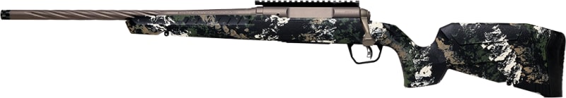

Does anyone Have experience with the Savage Axis II Pro in 22-250 or .223
The reason I'm asking is that I'm looking for a cheap range rifle in left hand. I have an extremely expensive 22-250 (H.S. Precision HTR) that I used to use for matchs but have basically put it up in the safe for a rainy day. It has tons of barrel life left and I want to keep it that way. I also spend a lot of range time with my AR platform that I have 2 uppers for.
I found these on Classic firearms and I'm itching to go for one of them. I'll need to sneak this into the house under the boss's nose! LOL
