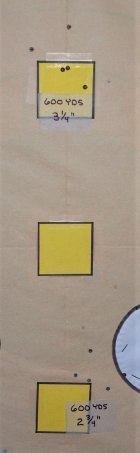

An example of one, but a different take on losing velocity....
When one of my Dasher barrels was gradually losing accuracy to the point I felt wasn't competitive any more, I pulled it after the last match. The barrel now had 2629 rounds down it. I read where guys will run a barrel till the velocity drops off before replacing, and since I had never chronoed a barrel in it's later life before, now was the perfect opportunity, as I still had a few loaded rounds left over.
I setup the bench, the chronograph, and ran the target out to the 600 yard line. Conditions were light, a slight breeze, but I didn't bother with wind flags. I shot two, 5 shot groups, writing down the speeds after each shot. Loads were with Varget and moly plated 105 Bergers. I had run the same load, regardless of temps or conditions, it's whole life, at 3075 fps. I was surprised that the velocities today were exactly the same as when it was new. The two groups average a half MOA, nice, but not competitive.
