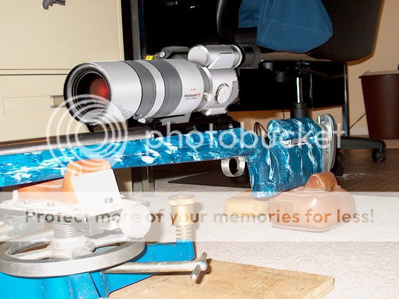

But will it take the recoil? Hummmm Now do ya' hock up the trigger to the camera button, or the camera button to the trigger? Hummm....
I kind of like it! Heads up shooting.
Note: this is photoshop at work here, I don't have one, just checking what it would look like.... hummmm... notice it even has a scope level

Very nice photoshop work, but in fact, a digital scope outputting to an LCD screen could be much smaller than a conventional scope because: 1) it won't need knobs or erector assembly; 2) It doesn't have to output a light beam visible to the human eye. Consider the Laser Rangefinders. The front objective would be about 1" in diameter, overall length about the size of a maglite. An integral clamping mount would eliminate the need for separate rings.
The digital spotting scope in your pic has to have such a big lens to provide enough light to the conventional rear lens viewfinder.
Recoil might be an issue, but I bet the military has that already figured out.
With a 5 mpxl CCD, 10x base magnification and 6X digital zoom would be do-able with a fairly compact OAL, particularly if the power came from the base unit via a USB-type cable. Basically all you need on the rifle is a chip and a couple of lenses in a tube. No moving parts other than the cross-bolt for the mount.
