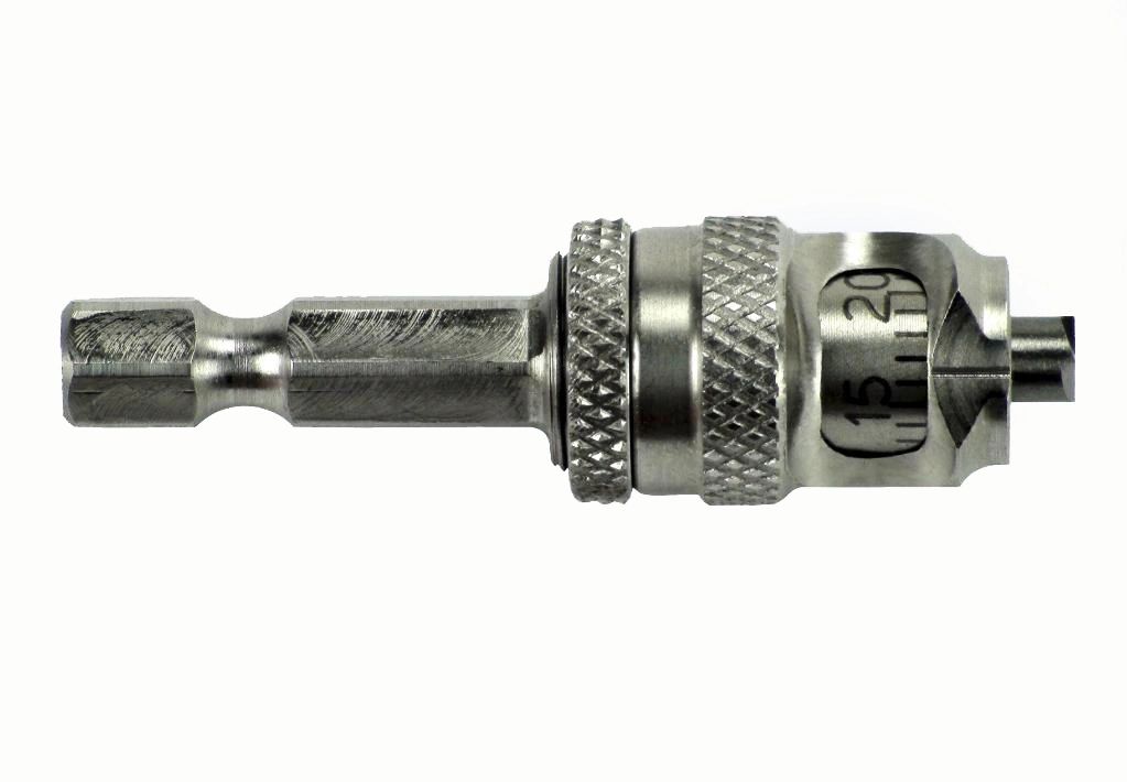

Who makes a depth adjustable primer pocket uniformer ? I have the Sinclair non-adjustable ones but it does not uniform the bottom of the pockets until the brass begins to move which can take several firings. Thanks in advance.
I have an RCBS and the 21st Century uniformer. I like the 21st Century best as it's really easy to make adjustments . . .AND is a hair smaller in diameter, which work better in those cases with tight pockets.

I use the PMA Lapua non-adjustable and it cuts the whole pocket. Are you having trouble with Lapua or something else? Just curious if I need to prepare.

If it does not uniform the bottom of the pocket that is because the pocket is already deep enough, or maybe too deep. Primer pocket uniformers aren't a tool to just flatten or clean all primer pockets, but they often in fact do that, to some degree or another, if a given pocket is getting too shallow and it gets uniformed, partially, or fully.

I wouldnt say it is trouble but the brass has to move before it will touch the bottom of the pocket therefore not cleaning it.
Bill, I have a Sinclair primer pocket cleaner and a Sinclair primer pocket uniformer which is adjustable. I rarely use the uniformer because most of my brass is Lapua. I do use it occasionally on some of my old Rem & Winchester brass, to be honest, I rarely mess with primer pockets, unless there is a problem which is extremely rare, especially with Lapua brass.
You are an experienced precision shooter and probably know a lot more that I do, so I offer this only as my experience regarding primer pockets. Also, this is offered in the context my shooting discipline, precision varmint and predator hunting.
Over the past 50+ years like many, I have always sought an edge to improve performance. For many years I just cleaned the pockets with an RCBS cleaning tool to remove the gross primer residue. I still believe this is important to obtain flush seating (slightly below the rim of the case).
Seeking improvement, several years ago, after reading many articles, I purchased the Sinclair pocket uniform tool and started uniforming primer pockets. This did an excellent job on most cases, but like you, I experienced some cases where the pockets were a few thousandths deeper, and the tool would only uniform a portion of the pocket.
After years of doing both (i.e., uniform and not uniform) and shooting thousands of practice rounds on target, I can tell you that it has made no difference that I can detect on target.
The one concern I would have with a uniformer that you can vary the depth of cut is that one might cut it too deep thus creating reliable primer ignition problems. So, take this for whatever it is worth.

Yea I have often wondered if it really made a difference on the target.

I like the K&M, just to clean the bottoms.
