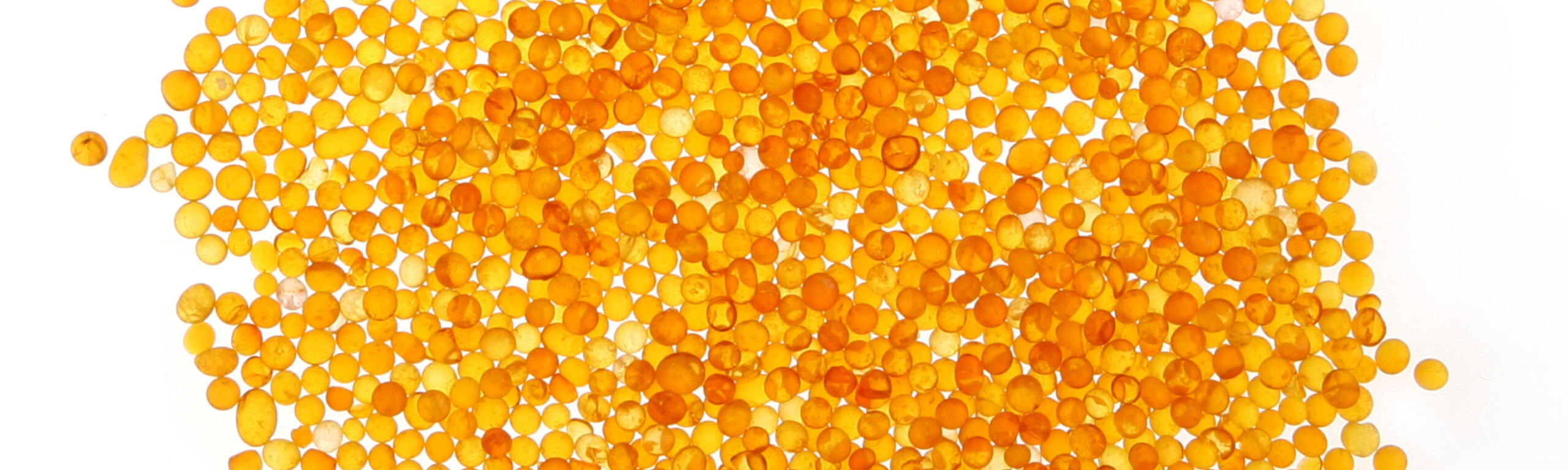

On a side note, depending on the concerns there are plenty of shooters (including myself) now using desiccant packs and these kinds of devices to control humidity in their powders long term. Might be something to look into.

Desiccant packs don't really work. I would have to look the article up again. I will try to find it. You don't know what condition they are in when you buy them. You can dry them in the oven.
Basically, a pack can only absorb about 40% of its wt. in moisture then they don't work. The real problem is you have to calculate how many packs you need based on the volume of the container and how much moisture is in the contents. Then you have to determine how often to replace the gel packs based on when they quit absorbing
I don't use silica gel because of the PITA. I get the moisture absorbers at Dollar Tree, and consume ~30 per year across my safes, powder and reloading gear. I swap them quarterly as needed and glance at them every time I'm in the safe or cabinets. They do work.
