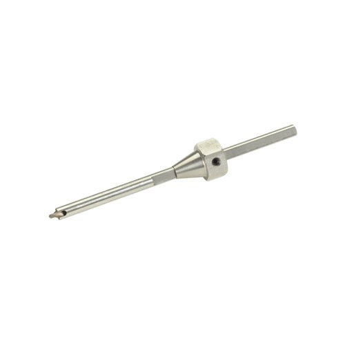

I was just messing around while cleaning some cases and decided to see if any more material came out if I stuck the flash-hole deburring tool back in some cases that had been fired. These cases were deburred initially before firing. No extra brass was removed from a good portion of the cases, however, about half of the cases did. I was kind of surprised at the amount of brass that was removed. What causes this? Incomplete deburring on the initial attempt? Brass flowing after being fired in areas where the cutter can engage? When I initially deburred the flash-holes I took my time and made sure that I had removed all of the bur, so I am a bit surprised that anything would still be there???

Flash hole cutters work differently - you didn't say which you have and how it was adjusted... and if you did anything to the cases like trimming.

I used the Sinclair tool.

I have the same tool - it is a good one.
Do you adjust the top piece so it rides in the neck to center the shaft??
If so, that is probably your problem - when cases are fired, most of the time they change length - sometimes they get longer and sometimes, shorter... depending on a few variables.
That is why it is suggested that cases be fired once before being trimmed or turning (or most anything else)... so the case can "settle" into it's new home ;)
If you set the cone part to firmly touch the case mouth, it will act like the stop, and if the case shrinks, the tool cuts more.
The tool has it's own stop at the cutter, and if properly set, the first cut is all it will cut - it will not continue to cut.
When you set the alignment cone, leave a little space - don't bring it down onto the case mouth.
