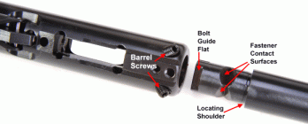

I believe all the 452 actions are straight tennon and pinned. The new 455 actions are threaded.
JRS said:
Threaded. 20mm x 1.25mm.
What he said. For the 452. I gotta spin a barrel up for mine. Green mountain blank should be here soon. Just need to get the reamer and get after it. But I do have to wait to do it on my buddies Cnc lathe as I have no metric gears for mine.
