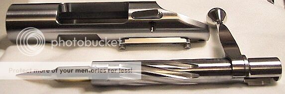

Master_photog: I hope I didn't confuse the issue re: the BAT SV's recoil lug when I posted earlier. They have a cutout on the bottom of the action that acts as the recoil bearing surface....just not a standard front mounted lug like a 700 does. The BAT site doesn't show a very good picture of it from the side, but here's what they say regarding it:
Our smaller actions have a cut in the bottom of the receiver that when properly bedded acts as a recoil lug, sometimes refered to as an XP cut.
Also, here's a pic of one from the side that shows the cutout:
I prefer a traditional front mounted lug (for several reasons), but that's neither here nor there.
Sorry if I muddied the waters...hope this helps. -Al
