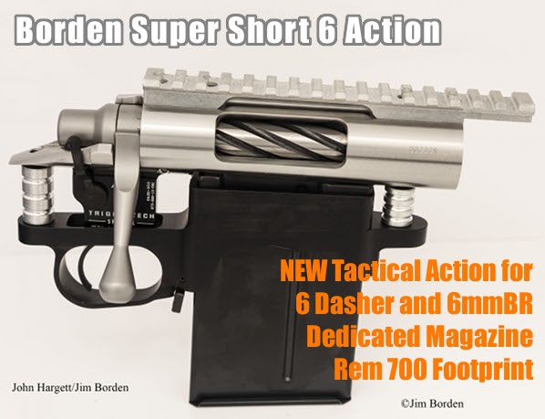

Custom? I don't know. Unless Borden makes something that's not advertised, it appears that they're all ~1.35"+ diameter actions using roughly Rem 700 footprint(s).
The 'Super Short' doesn't meet your requirements but it does handle the 6BR family of short cartridges.
Here is the description from Borden Rifles website:
“The new action from Borden Accuracy (Borden Super Short 6) features a Rem 700 short action-compatible footprint with a shortened magazine well and shortened port set up specifically to reliably feed 6 BR, 6 Dasher, 6 BRA, 22 BR cartridges. The bolt has modified Borden bumps to aid in cycling in the dirty environment. The pictured action shows our standard bolt handle and tear drop knob. Production models will feature a handle that is threaded on the end so individuals can use their preferred knobs. I have been one of the individuals that developed the bolt timing and neutral handoff with the trigger for competition shooting to minimize rifle upset in the bags when closing the bolt. These actions will be available with either the neutral timed handoff or with about .03 to .035 inch cock on close. The cock on close option has much easier bolt lift that seems to be favored by PRS competitors. For now the bolts will have spiral flutes but future versions will have diamond flutes as an option. Development work will be done to also handle the .223 Rem and the PPC family.”
