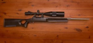

I have just finished running in my new 6br 1:10 barrel and I am off this weekend to give it a run in the bush.,pic attached)

Muzza,
Great looking gun, what stock and action are you using?

Hi Chuck,
The action is a Shilen DGA, the stock is a laminated copy of a fibreglass shilen thumbhole stock. There are a few improvements that have been made such as reduced drop in the butt and a 1/2" flat on the underside of the butt, the stock has also been hollowed to reduce a bit of weight - basically just moderising it a bit.
