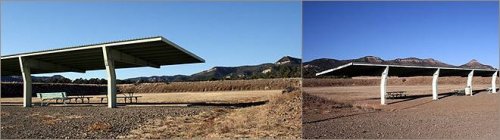

Raton New mexico at the NRA Whittington Center. Should be pictures on there web site. Nice Cantalever with no poles in the front and seems to hold up to those harsh NEW Mexico winds.
Check it out.
RussT

Could not find pictures.
