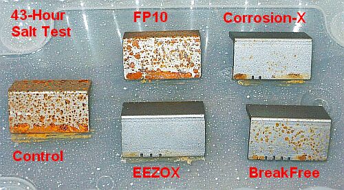

Along with Eezox an Boeshield T-9, Corrosion-X is one of the very best,non-grease) products available. It does leave a slightly waxy finish, whereas Eezox goes on clear.
Check out our rust-fighter comparison test:
http://www.6mmbr.com/corrosiontest.html
Mr. Moderator,
Completely forgot that Corrosion X was uses in this test. I thought that it was a new product on the market. This makes two separate independent test where EEZOX came out the winner hands down.
I used to shoot sea ducks several times a year with a Browning BPS shotgun. I could watch the rust forming on that gun while sitting in a saltwater blind. Switched to EEZOX and the saltwater did not cause any rust at all even after several days.
