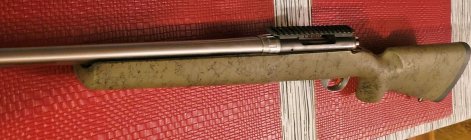

I am building a Savage small shank 7mm-08 rifle. I recently purchased a used HS Precision stock from another member, and it won't be including the trigger guard. So, my question is if the HS Precision stock is designed to take the equivalent of a stock OEM Savage trigger guard? I'd assume so, but I can't find any info on their site. I want to order one soon, but don't want to get one and have it not fit. Thanks

This photo is of the stock and barrel that's coming, and the action in next photo. The action shows the top bolt release, with bottom metal for blind mag. I found some trigger guards on Ebay and Optics Planet, but don't know if they're correct for that action. I assume the HS Precision stock would take an original OEM trigger guard? The photo of a stainless version seems to be the right one, as the action is small shank short action Savage 10/110, but says it fits the Axis model too.

The stock isn't blind mag right ?
The bottom metal that I have is a bottom bolt release so it won't work for yours.
I have found some good stuff on ebay
I'd wait until everything is in hand, then do some measuring. Then order the trigger guard.
Savage seems to enjoy changing action bolt spacing, bolt release location, recoil lug shape, barrel nuts, etc.
Ask me how I know.
