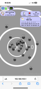

Johnny, I look at that target another way, if you had taken two sighters and gone for record, you would have had a 200-15X instead of a 199-13.
As importantly, you’d have 6 more bullets, about 9 dollars of powder, and 16 dollars of primers unused, too :).
