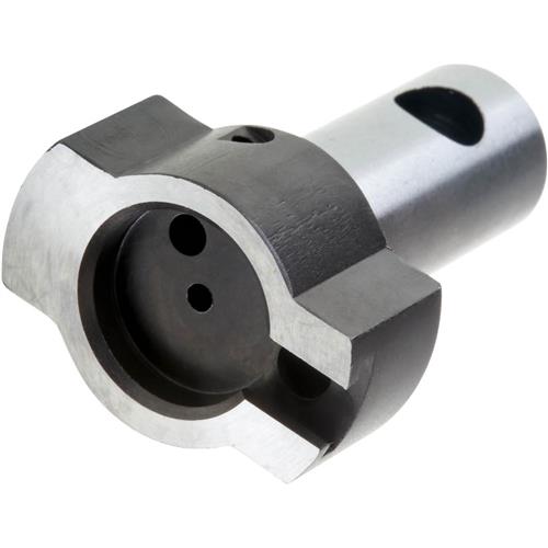

Convert savage 12 lrp 6.5 cm to 6xc?
You don't need another bolt....They'll use the same size....But if you want to change bolt heads just for the sake of it here's an option
http://www.grizzly.com/products/Savage-Bolt-Head-308-SA-RH/T27333
I have a couple of these and they are top notch.
I understand. The only reason I have the 2 that I do is because the projects had a different size case head than the factory rifle had originally. They are pretty expensive now....When I got mine they were 50 bucks

ZERO need to change Bolt,You can get Any Caliber that fits your bolt face,NSS has Match C Moly or SS barrels for $300,I'd get a Precision Barrel Lug and Prec, notched Barrel nut. If you are swapping it put yourself,you will need Barrel vise and barrel nut wrench,and a Go gage,you can use .001-.002 piece of tape/paper or shim stock on back of Go gage for the No Go gage.
