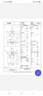

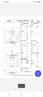

I have an idea, I don't know if it will be good, 7SAUM brass could be formed using 6.5PRC lapua brass, they are quite similar at least in the L1 measurements and in the shoulder angle.
Would that be a good idea?
Would I have any problems if I ran it in fireforming?
Someone has tried?

Base of 7 SAUM is a little over .020 LARGER than the 6.5 PRC. Not a good option. The rim diameter is GTG but the base at the .200 is MUCH different
