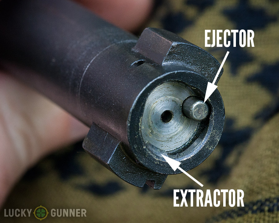

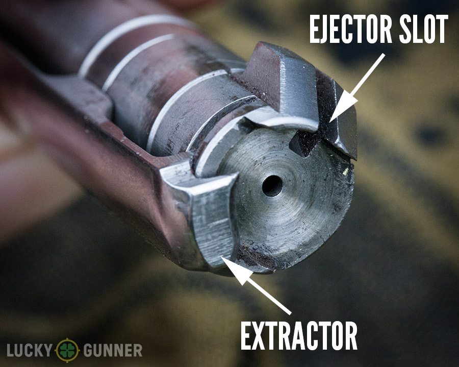

These loop videos migh let you see what takes place within both cycles:
Controlled Feed vs. Push Feed Rifles - What's the Difference?
