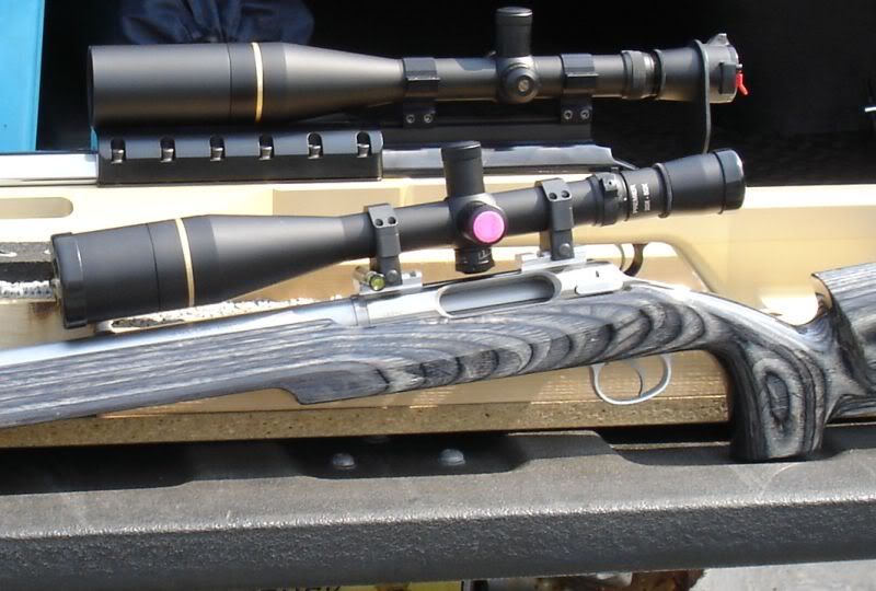

Here's Jason's 6BR. He was using a stout loud of RL15 with CR 106s, jammed.
Let me be the first to ask,on this thread at least), what is with the 90 degree out of plane scope mount?
No doubt there's a reason for this - I'm intrigued.
BTW - nice stock - identical to the one I have :D

OK guys. Seen the pictures, now some questions. What about that stock? Good looking! Could that be a A5L from Joel Russo? No matter. Sure looks nice! Mike.
The 90-degree rotation is really a smart trick for shooting long-range at a single known distance. The parallax control is rotated to the bottom, since once that is set, you won't need it anymore. Likewise, windage is more likely to be changed than elevation, so it is right on top where the numbers are easier to see and Jason doesn't have to "reach around" with his loading hand to get it.
It's not a solution for all situations, but it obviously works for Jason at 1K.
Actually, the windage adjustment becomes the elevation adjustment and vice versa. But now the windage know is on the left side where it's easier to see for right-handers.

rstreich said:
Hmmm. If Jason's Leupold LRT is like mine, when you rotate the scope 90 degrees counter-clockwise, as shown in picture, the elevation turret,pink cap) is on the left,at 9 o'clock), and the windage turret is TDC at 12 o'clock.
Yep, but now the elevation turret moves the reticle in the horizontal plane and the windage moves it in the vertical, so they swap roles.

As to why i didnt shoot it in light gun...didn't think it would do that good :rolleyes: Thought the 284 was GTG, but appears going to 1X fired brass instead of virgin knocked me out of the node :,
RE: turned scope...parallax is no problem to change, there is enough room to get at it...i use it from 200-1000 no problem. I swapped the turrets so the knobs read correct, thought the Windage moves opposite what it says...but that was fixed with a little dremel engraving bit and a sharpie,blacked out the "R" and engraved an "L" :D
JB

That scope trick would F**K me up. I just know I would turn the top thinking I am going for elevation...wahoo an 8!

What primer are you using....and what action and bases and rings are those ...I cant tell from the pic,,I need to get out more often!!haha))...also what bbl and twist and FB...just curious...might want to try sumthin like that one day..,wink)//....Roger
Thanks guys!
Roger -- most of your Q's are answered in the GOTW...Rings were TPS with the 50x leupy, and Ken farrell on the 1" sightron...
