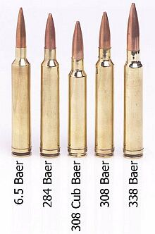

The Baer cartridges are based on the full length Magnum case,2.85") while the 338WM is one of the short magnums,2.5") and the 300WM is .1 longer at 2.6". see my photo at the start of the thread. the 300 WBY and 300 ACK MAG are full length magnums.
Todays "short" magnums such as the 300WSM are actually wrongly named and confuse a lot of younger shooters. The true short magnums are usually 2.5" long. 458WM, 264WM, 338WM, 7mmRM, 308 and 358 NORMA MAG, plus all of the various wildcat short magnums such as the Apex, Luft, Ackley. All very confusing to a new guy.

Exactly. The 300 H&H IMPR, 300 ACK MAG, 308 BAER, 300 WBY IMPR, all the same thing. Then throw in the cartridges without a belt, such as those made on the 8x86S brass, and you get an idea of what a shooter trying to pick a competition cartridge is up against.
In my thread I mentioned and showed the 300 AMU cartridge and said you can identify it by its headstamp. Well that headstamp is the REM-UMC 300 MAGNUM with the "MAGNUM" part ground off. Now I'm starting to give away my collecting secrets.:rolleyes:
