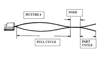

In the movie "Easy Rider" Dennis Hopper says "I'm getting bad vibes man, I'm getting bad vibes".
And barrel vibrations are your "bad vibes" when looking for the "node".
There are two ways to tune a rifle, tune the rifle to issued ammunition like the military or tune the ammo to the rifle.
I node you all would understand. :) (even F. Guffey knows this) :rolleyes:
Barrel vibration is inherent and inevitable. The best we can do is dampen and manage these vibrations in a controllable fashion. Tuning the ammo to the gun is one way to time the vibration with bullet exit, in our favor and is what hand loading is really all about.
Tuners allow us to tune the gun to the ammo. You can tune the combination to its potential but not all loads nor components have equal potential in a given gun, just like not all guns have the same potential. That's why we should find the best load in a given gun before tuning with a tuner. Often, the two do coincide.
Take a 6PPC for example...There are numerous proven good loads that seem to work in a lot of them in a given condition. Those same loads can most always be made to shoot in your gun with just a slight nudge of the tuner. But it will always leave you(me) wondering if I'm leaving anything on the table with the load's potential.
