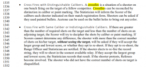

In case someone crossfires on your target, you will be able to distinguish your bullet holes from the shooter that shot your target.
Actually, painted bullets will not help you with crossfires, according to the IBS. I know some ranges do it, but it will not help you at a national shoot. I think maybe now Freedom may allow the range officials to use painted bullets to figure out what is what.
