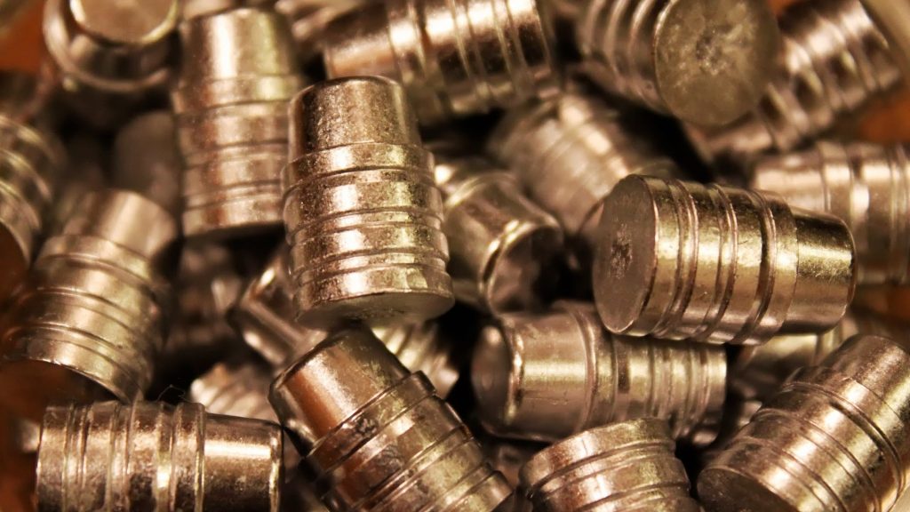

I found a quick and easy ( all things are relative ) way to clean the waxy lube off of cast lead bullets. Why I say easy is that I tried several methods and scraping it off one bullet at a time and then finish cleaning with xylene was the easiest until today.
I took a box of 500 9mm cast bullets with lube, placed them in a small sauce pan, covered them with cheap vegetable oil, placed them on the stove and heated slowly. When the pan reached about 200*f the waxy lube disappeared into the oil. Just vanished out of the lube groove.
After letting it cool to about 150* I strained the oil off and placed the bullets on paper towels to absorb the excess oil and rubbed them with a few more towels until the towels quit looking oily.
I then placed the bullets in a bowl with table spoon of Borax and two tbs of liquid laundry soap in a quart of hot water. After letting them soak for 5 minutes I agitated them with my hands for another 2 minutes. Rinsed thoroughly and let them dry. See easy, 500 done in just about half an hour (minus the cooling time).

Just an update: I powder coated 100 of the bullets last night and it went well. The powder stuck to the lead just fine and when heated didn't have any lifting issues. So after the cleaning in just soapy water no further cleaning is required.
2nd, after the vegetable oil cooled completely it is obvious that the waxy lubricant is in suspension in the oil. Vegetable oil was selected because it is a non-polar solvent, like gasoline, and toluene and xylene, but is much cheaper and easy to dispose of. I think it could do another batch because it was still clear and completely fluid when warm though now it is cloudy and slightly jellified.

I just bought a cheap cookie sheet at the dollar store, stood all the bullets up on the sheet (much easier if you put the sheet on the oven rack before loading) and put in the oven for 20 minutes at 225. All the lube melts out of the grooves.
Turn the oven off and let it cool. Once it is cool and the lube has solidified, take the sheet out of the oven. Most of the bullets will pull out of the lube just fine. If any lube sticks to the base of the bullet should flake/wipe off without a problem.
Then re-lube or coat as you wish.
