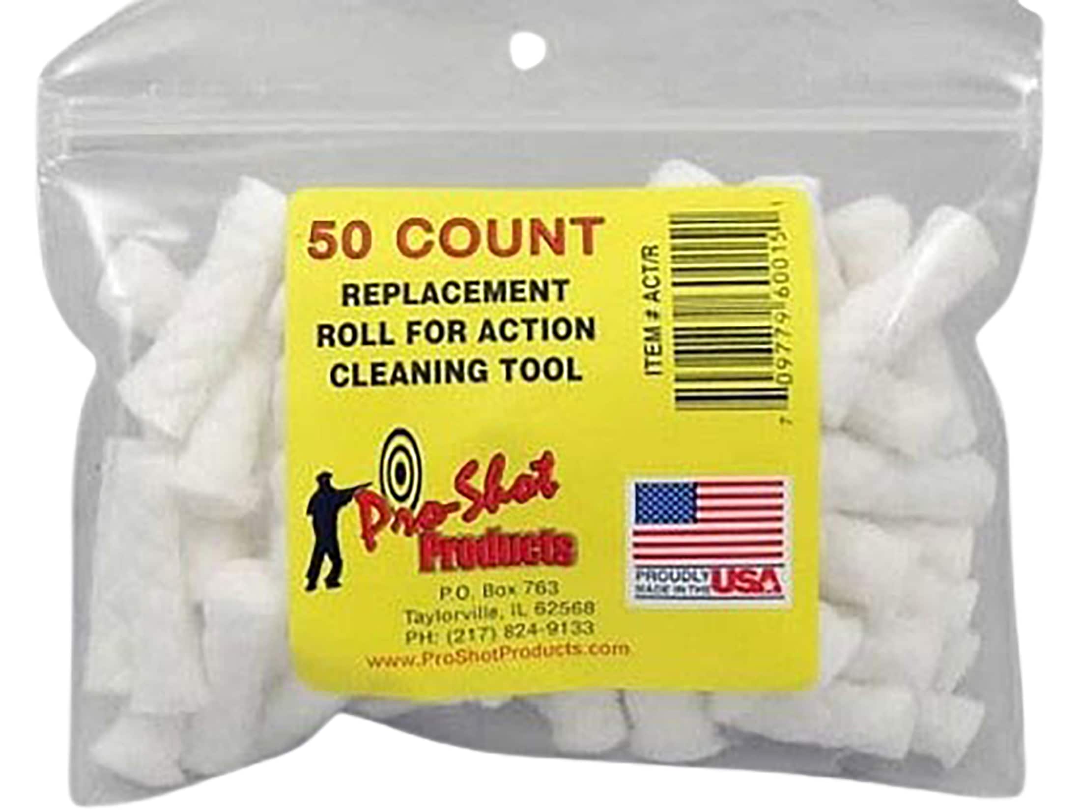

what you are looking for are dental cotton's. Those are the tootsie roll type of cotton rolls that are used to clean the locking lug areas of the action. You can make a split wood dowel to hold them.

I use the Dewey lug area chamber cleaning tool with their special cotton cylinders. It does a very good job cleaning this hard-to-reach area.

This is what I use. It helps to file the set screw down a bit. The one it ships with is too long.
Also, make sure to clean the lug area on the action out really well any time you remove/change barrels. Use an air compressor to blow out any crud and god forbid any kernels of powder.
