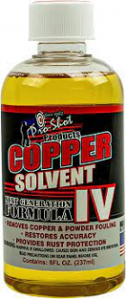

Is there an all around cleaning chemical for carbon & copper or do you have to buy separately for both & what’s the best you guys have found ? For gun barrels of course.
This is my fav copper cleaner. Not caustic, no awful smell, smooth on the skin. I can put it in my bore and leave it for 10 minutes or 2 days. (I have done both). It's just far more user friendly that sweet's.
