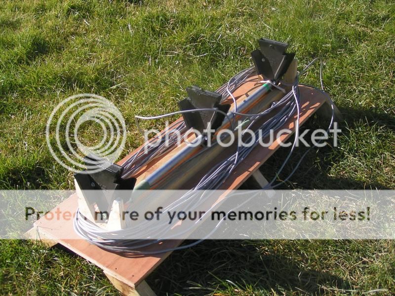

Chronograph set up for testing in prone position
How are most testing or are you testing off the bench then going to prone after?
The intended use will be for Fclass shooting
LabRadar is taking forever so might have to go with Oehler 35 model
Magnetospeed affects accuracy, so only good for obtaining speeds and no more.
I use an Oehler 35. Screens are mounted on a 1x6 that I just put on the ground and shoot over it.
I have my Ohler 35P rail attached to a QD adapter so that I can snap it on to a regular tripod when shooting on a bench. I imagine (have not done this) that you can have a male part attached to a 1" thick piece of plywood that is long and wide enough so that when you snap the rail on it, it would basically sit almost on the ground and be stable. The only down side I can see is it would be difficult to level the board/rail combo if the ground was not flat, but I guess one can put leveling feet at each corner to fix this.
Question: if you use a magneto speed, you are attaching a weight to the muzzle of the rifle, therefore altering the mass and harmonics of the barrel, therefore altering the way that the rifle produces the muzzle velocity for a specific load?
I use optical chronographs for fear of doing the above.
Thoughts?
This is only a 2ft bar and is purpose built for where I do my load development, it's completely flat ground but with a slight up hill gradient and it takes one or two minutes to set up. Getting it aligned is just so simple, obviously it's not that simple on a range firing point.
I plan on making one with a 4ft or 6ft bar and with height adjustment, but for the time being this serves my purpose.
As you can see it has lived a charmed life and I really want to say all the bullet strikes aren't mine, alas one of them is.
I think you actually have done real well. The problem is when the rifle is not attached to a rest of some sort, the actual height of the barrel can vary and this is I am sure you know what causes bullet strikes.
Even with a good rest and using a laser bore guide to adjust to the proper height, recoil can move the gun laterally causing reading errors and potential strikes to the supports. My solution to the lateral movement is to chalk in the points where the legs of the rest come into contact with the bench. Works but I am hoping to move to a LabRadar in the future.
dickn52 said:
Probably said already. Shoot off the bench. Speed is speed and not directed by closeness to the ground.
My theory is that benches unless made out of concrete can move, where as the ground doesn't, or if it does you're not fully aware of the situation around you.
