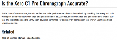

Pretty much what @cem said. I'll just emphasize that chronograph alignment is crucial anywhere that dead-nuts accuracy is desired. Doppler chronos in particular suffer from high susceptibility to alignment errors and sloppy session-to-session placement. But even excellent optical chronographs can show variance if sky screens are not placed precisely, each time.
But, yeah, inherent accuracy of high-end chrono units are quite high, with specs from Garmin, LabRadar, and Oehler in the 0.1 - 0.5% range.

But how accurate are these instruments?
Labradar LX, like other radar units, claims +/- 0.1%, so at 3000fps your margin of error is +/- 3fps.
On the Labradar V1, Litz had some very complimentary things to say about it in his books, musing that it could replace the Oehler 35 as the reference standard.
In practice, with Labradar-derived BC and FPS, i get first-round 1MOA hits at 600+ yards.
