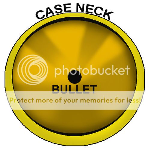

I just finished 200 rounds and have some ideas. The cases aren't being impacted hard enough to bend anything. I think it's a combination of tolerances that may be causing the runout in the first place. The last 100 were Hornady cases and only had about .001" interference fit. That may not be enough. I have measured some Hornady Match bullets that are .0004" out of round, some Sierras at .0002". There are tolerances when the necks are turned. Nothing is ever perfect. I measured several cases that the neck turning cut all the way around. They were .0006" - .0009" runout in the middle of the necks. I don't have a small ball mic to get inside to measure the thickness but using a caliper and taking multiple readings, the thickness may vary by .0005". This drawing is exaggerated to show what may be happening. If due to a stack up of tolerances the bullet's larger diameter is horizontal and the case's is vertical, there could be as much as .001" difference in fit and tension. So this would be a reasonably snug fit when seating but the bullet is tight horizontally and has a lot less tension and (possibly next to none) in the vertical plane. The bullet could be slightly angled out of alignment with the case. I noticed some that took almost no force to move sideways. You could lightly tap the case at the neck with a pencil and it would do it. I noticed on several, especially these Hornady that had looser necks, that the low side measured on a runout gauge moved 180 degrees to the opposite side after lightly tapping them.
First thing, I'm going to stop using the .001" fit. I only did on the 208g loads that were right on the edge of showing pressure signs. Tighter necks may not help but couldn't hurt. I reloaded 9 of the Hornady and 6 had more than .002" runout measured on the bullet after seating the same bullet. At least, I was able to get 79 out of 100 at .001" or less and the rest at no more that .002" runout.

I have 2 observations :
1 - if your run-out is at or slightly over .003", then I'd say you have little to gain here.
2 - if your loaded ammunition actually looks like your 'hypothesised' image, then there are other issues to address, rather than chasing total run-out.

It's not as bad as the picture. It's overdone to show what may be going on. Like the bullets. I only had a few Sierra Match Kings to measure but they are as much as .0002" out of round on the bearing surface and some of the Hornady Match are up to .0004". And cases probably aren't perfect either when you start looking at them in ten thousandths increments. It the wide part of the bullets happens to seat in the narrow part of the case neck (maybe only .0002"), then the tension will vary around the diameter to some degree and most likely go unnoticed. Like you said, probably little to gain but if I can make them better, I will try.
