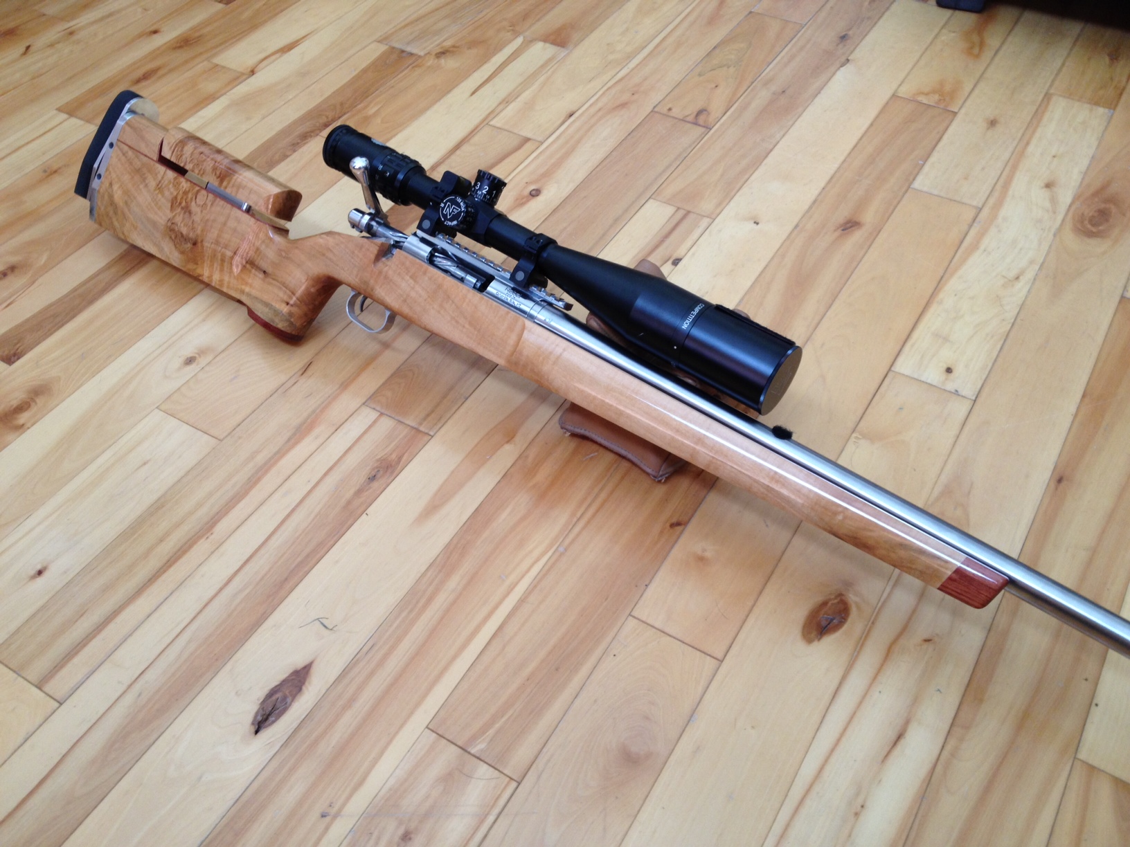

I notice a lot of the wood stocked rifles have really long fore-ends...are the chassis systems and composite premades like manners long enough?
We can easily make weight with an aluminum stock in 1k Br, its been done, its also been done in short range. The reason you do not see them on the line is damping qualities. Wood, fiberglass, foam, exc. have very good damping qualities. The stock has to absorb and transfer the harmonics out of the rifle and into the sand bags or ground. Want to know what happens when harmonics dont get absorbed from the rifle, shoot with you forend against a hard object. Bottom line, a wood or glass stock has more accuracy potential than an aluminum one of equal design. You will see some extremely large Heavy gun stocks. 60lb rifles. Pure mass is the damping quality there, same as with machine tools. How ever I do not believe a true heavy gun will agg with a good light gun. So my opinion is to stick to a wood or fiberglass stock, and stay away from carbon fiber layups. Some carbon stringers between wood wont hurt you but I would not order a Mc or Manners with the carbon fiber/graphite shell for a long range rifle.

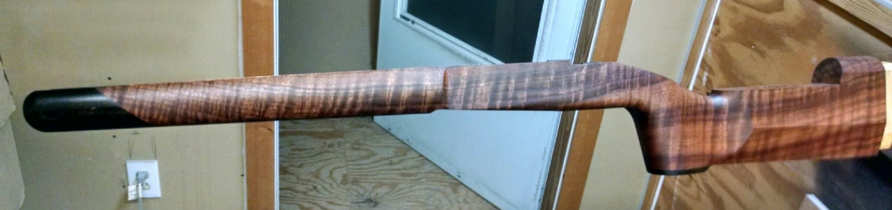

I agree and would add that a stock should insulate the metals bits from the support bits so that the metal bits can vibrate the same every single time.
Wood for me.
