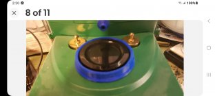

Im trying this method to save pulling bullets later, make up my test rounds at home and take pre weighed charges in dram vials and prepped brass.
