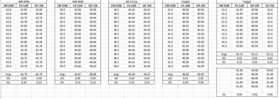

Like rigndael's comparison, I did one like it and shared it some time ago and here it is to help give you some idea of what you can expect:

It's my understanding that the Chargemaster Supreme has the same load cell as the Chargemaster 1500 with a .1 accuracy. So, no real change in "accuracy", though the consistency of the throws seems be a bit better. But, the Supreme definitely does have a lot of great improvements . . . a big one being its speed.
