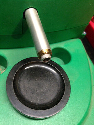

Go to a auto parts store and get a brass fitting for a fuel line . Insert the hose end in your CM. You want a snug fit not a forced one. You may need to take of a little brass with sandpaper . with this insert i get one over run in 200 +/- charges . With 4831 4350 etc. You may not need it with ball powder BLC2 and the like. Tommy Mc

Was this what you're talking about? Had this pic on my computer desktop for several months. I think I downloaded it to send to a shooting buddy; don't remember now.

Yes Sir It will solve allyour problems. Glad i could help Tommy Mc..Dont you just love it when a plan comes together. l
