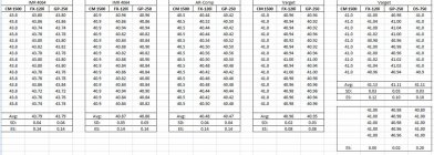

I purchased an FX 120i from a member on AS. Didn't really plan on buying it, or one at all, but it was a good price so I bought it and, after checking it out, put it aside.
Today I was loading 30gr of Varget with a Chargemaster 1500 and decided to verify the loads.
Pretty widely dispersed, from a low of 29.92gr to a high of 30.12gr. More variance than I would like to see. Pretty disappointing actually.
That was Varget, IIRC. At the time my load was 43 of Varget with a 175 SMK.
The CM only has a claimed accuracy of 0.1 gr. The FX 120i has a claimed accuracy of 0.02 gr. So given those numbers, your CM is meeting the design. If you adjust the programming of your CM you could either change the speed or the accuracy.

The 1500 scale is only accurate to 0.1grain, therefore it will not be able to differentiate more precisely… when you compare (check) with a more accurate scale you are exposing the limits of this 0.1grain accuracy. Nothing can be done to improve this short of re-weighing each charge on a more accurate scale and adjusting accordingly… this is what I did for years.
I'm not following you. In each case the CM read 30.0gr. What adjustment would produce different results?
As you said, the CM is meeting the stated accuracy.
When the CM reads 30,0 gr, the actual charge might be 29.9 gr, 30.0 gr, or 30.1 gr. The scale is only capable of +/- 0.1 gr. Does matter what the display on the scale says.
Just like the FX 120i is only good to 0.02 gr. So a charge that displays as 29.62 gr, might be 29.60 gr, 29.62 gr, or 29.64 gr.
What adjustment would produce different results.
If you start the slow trickle at a lower charge weight (% of the set weight) it might improve how close the actual charge is to the set charge weight. Just like using the separate trickler does. Most folks go the opposite way and speed up the charging, which probably reduces the accuracy. When I would load 7,000 rounds for my annual prairie dog hunt, the time to dispense the next charge was more important to me than the exact accuracy of the charge.
That is what Eric did in the video. The scale is capable of greater accuracy if the setpoint is approached more slowly.

Chargemaster is a great tool. It’s not designed to read each individual kernel, but is very accurate if you perform the McDonalds straw and programming modifications. Mine seems to always stay within +/- .04gr when charges are verified. Depending on the powder type of course.
If loading serious rounds, it’s best to set the weight a couple tenths below the target then trickle in the rest on a finer scale. For varmint and pistol rounds, I just let the CM have at it and it does an excellent job. Absolutely nothing that disappoints me about the CM
