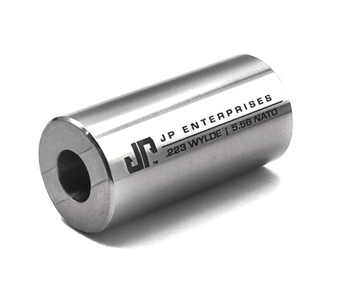

I also use a JP Enterprise case gauge that is smaller in diameter than most other case gauges. I use it to check case diameter after sizing my once fired Lake City brass. If the case fits in the JP Enterprise gauge it will chamber in any rifle.
Below a Wilson, Dillon and JP Enterprise .223/5.56 case gauges with the case placed in base first to show gauge diameter. Wilson and Dillon type case gauges are OK if the case is fired in your rifles chamber and are closer to max SAAMI diameter. Meaning a fired case may drop all the way into the gauge because of its larger diameter. There are videos on YouTube showing the Wilson type gauges and chambering problems with standard type case gauges.
JP Semi-Auto Case Gauge
.223/5.56
Optimized for semi-automatic rifles, the second generation JP Semi-Auto Case Gauge guaranties function of your ammo. If it fits our gauge, it will fit even a minimum-depth SAAMI chamber without interference.
Take comfort that your ammo will never hold you back.
Features:
  • Specially calibrated to ensure function in semi-auto rifles
  • Guaranties ammo fit in a minimum-spec SAAMI chamber
  • 416 stainless steel construction for wear resistance and greater longevity

There is a difference between brass fired in your chamber vs range pickup or buying once fired brass like Lake City. And rather than dissembling your bolt or fumbling around with a semi-auto, a minimum diameter case gauge is much faster.
Watch the video below, fired cases and even a damaged case will fit in a Dillow case gauge. You are also better off using a Hornady gauge to check the fired location of the case shoulder and then checking your shoulder bump.
Watch the video below and the difference between a Dillon and JP Enterprise case gauges. I load for two AR-15 rifles and a bolt action savage .223 and the JP Enterprise gauge saves a lot of double work.
The Sheridan case gauge is another case gauge made to a smaller diameter.
