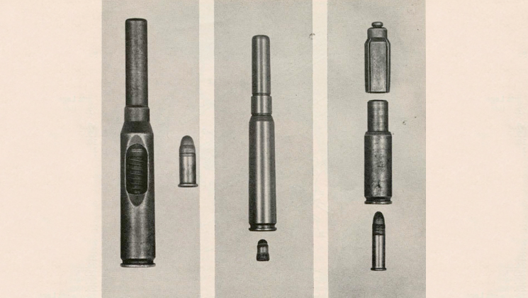

Been tried, and still being done.
Most popular is probably a 22 LR barrel insert to convert your 45-70 to use instead of having two rifles.

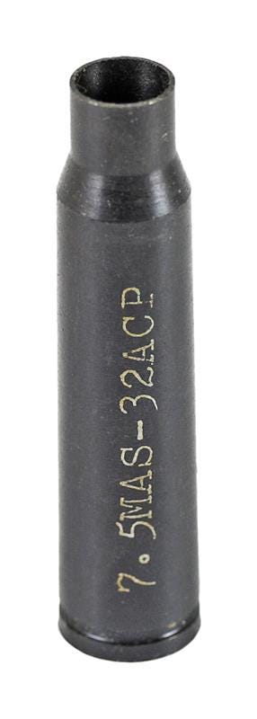

Marbles, made whole line of conversion cylinder sleeves. Popular conversions were a 32 S&W or ACP to be fired in any of the 30 caliber military rifles as low recoil trainers.
Rimfire adapters for about any thing that shot 22, 25, 30 calibers.
Hers a decent article
They show up on gunbroker and such regularly, Numrich always seems to have a few.
There’s probably a reason they haven’t caught on in the last hundred years, just no fun.
The 22 sleeves for big bores can actually be competitive tho.
