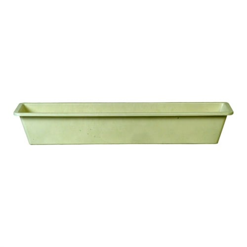

I use a two step degrease process using acetone in a couple of these.
When the first rinse gets really dirty I move the final rinse to the front of the line.
