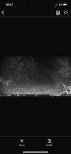

I have spy point cams. They take shitty pics compared to my old coverts, but they manage to get a picture out even with bad service. They sell them at academy with a solar panel add on. D2CDED95-677E-4B80-9128-1F6773F9A599.png
