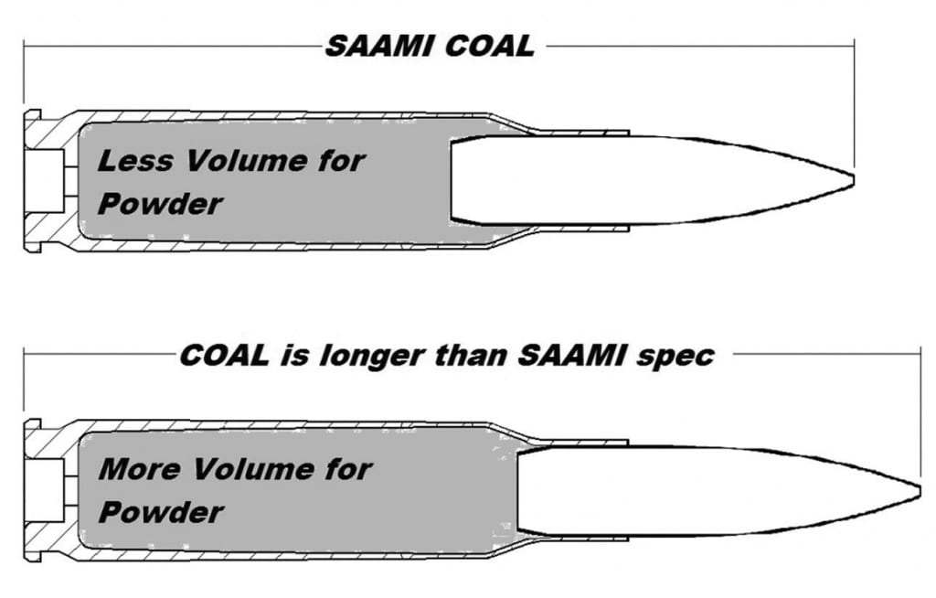

SAAMI cartridge length 2.700-2.825( you had a coal short of minimum)
Max case length 1.920 (so ogive should exceed that)
Chamber length 1.925-1.9408(SAAMI) so cbto will certainly exceed 1.925, probably 1.9408.
Without exceeding coal of 2.825(factory cartridge)
Bullet selection and the individual comparator body will determine what number you see. Make sure gage body are positioned to center the cartridge/case between caliper jaws(no canting).
6.5 cm generally have a generous freebore, this will definitely increase cbto and coal once you determine your rifles bolt face to jam length.
Size one case,no primer no powder. Seat a bullet to overall length 2.825. Measure cbto, record. Chamber in CLEAN rifle. Extract, check coal and cbto. It probably DIDN'T change, if it did(shorter because you pushed the bullet in deeper) that dummy cartridge bullet made contact with the bore(record new cbto). Seat bullet to 2.700 cartridge overall length. Measure cbto, record. Your best group will likely be between 2.700 cartridge length and max length.
