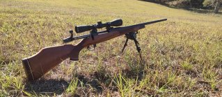

Gf has been talking about wanting to shoot her .270 more and more but after seeing the slow motion video I too of me shooting it she wasn't too keen on shooting it with regular loads..... Definitely not her dad's old hand loads ( he passed earlier last year and me and her got all his outdoor and gun related stuff )I shot lol but yeah told her I'd see what I could do with cast bullets to which she was super excited about having different colored bullets to plink with. So was able to get a single cavity lee mold off a guy on cast boolits for next to nothing, sizers gas checks ECT from NOE and was finally able to put something together. And right off the bat it's looking really promising! No leading to speak of light recoil, little loud but not bad at all with ear pro.
