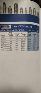

The Lyman hand book was kinda a waste of time since it basically says don't waste your time with cast and semi autos, but looking in the Hornady hand book I saw that most of the loads where running in the same ball park as what this bullet apparently likes for cast velocity (1700-upper 1900's is supposed to be ita happy place) soooo,did a little bit of a SWAG and decided 22.5 GR of accurate 2015 should be a good place. I've used accurate 2015 a good little bit in case .223 and it worked pretty decent and I just got a new can so hay I took it as a sign!

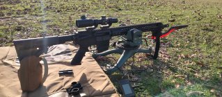

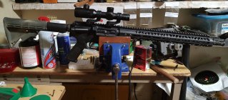

And today's set up. 50 yd feeding from the mag , front rest rear bag 1-4 monstrum LPVO bear creek 7.62x39 upper FMK Polly lower ( really really poor their beater gun , most of y'all probably have scope rings or bases that cost more then this entire rig :D ) magneto speed Chrono which I must say, isn't the biggest fan of cast lol, she's a lil picky
Now I gotta say I wasn't expecting much but after the first 6rd of getting on paper ( thing have been sitting around in pieces for the last few months so yeah it was a little off lol , bore sighting down the barrel usually gets me on paper at least but still was like like a foot high and to the left lol ) I didn't have ANY feeding issues, as far as the bolt not catching or picking up, did have to mortar the charging handle though but fixed the seating depth a little to hopefully alleviate that. And honestly that's most people's really big problem when it comes to cast and semi auto rifles is getting reliable functionality.
