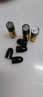

Got a bunch of coated 9mm for a good deal the other day. The problem is the bases are not coated as though they were ES sprayed standing up. Anyone have leading issues with uncoated bases?
Are you sure they are not coated? When I cure mine, I do it with bullets standing up on their bottom and it sure does appear different than the rest of the bullet but it is still in fact coated. Cut into one to be 100% sure. I find it hard to believe that someone would not coat the bottom unless they stood them up and spray coated the bullets with a powder spray gun. I've bought thousands before doing my own and never seen one with the bottom raw. But, there is a first for everything! :)

They are coated black so it's easy to see lol. I may post a pic when I get home. I don't push my cast 9 too hard. Some where in the middle of Hodgdons listed load for Titegroup and Berrys plated 124gr. I think it's 3.8gr Titegroup but thata may be wrong. I've never pulled one and looked, but they (Internet) say that particular powder doesn't play well with powder coat. I'm betting they were stood up on foil and sprayed with a gun.

Not 38 Special but I recently went through 500, 9mm 115 grain coated Acme. No problems at all. I used jacketed bullet load data. One point is, as I'm sure you know, 9mm uses a taper crimp whereas 38 Spl. is traditionally roll crimped. I've read that a mild roll crimp is needed because a heavy roll may strip some of the coating.
A properly sized cast bullet will seal the bore so that there is minimal gas cutting around the bullet. I stand up most of the bullets that I PC.
Most commercial bullets have a hardness around 16 BHN. If mild loading is used, there will be little obturation to seal the bore. And, if they are not properly sized, gas cutting will occur.
Holy smokes! Winner, winner, chicken dinner! See, there is a first for everything! HAHAHA
I'd burn those up in a pistol barrel (do not use with a suppressor) just to get rid of them and buy form another source! Don't let leading keep you up at night. It's easy to remove. All copper Chore Boy scrub pad (made for cast iron pans) wrapped around a nylon bore brush and a few passes back and forth takes it right out. Then follow up with Sharp Shooter R No Lead cleaner and you are golden. It's easier to remove than stubborn carbon in centerfire barrels.

Yes pistol is the plan. 800 for $52 shipped so I couldn't really say no. Plinking is the plan for a Kahr edc and a Springfield XD elite. I can recoat then size them myself shake and bake style if I want to get anal about it.
