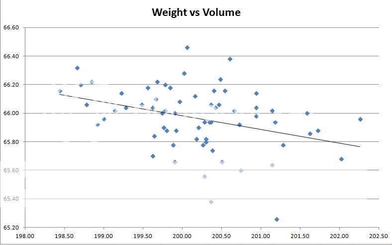

Here's some data on what the relationship between weight and volume looks like, Hornady brass, 284 Win.
That speaks volumes!
I just opened a new box of Lapua 6BR brass and weighed them, all are within 1.8 grains.....pretty darn consistent and from the above information a complete waste of time. Time to fireform.
