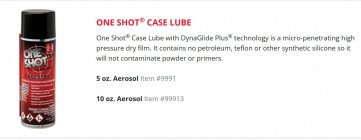

If my old memory serves me right. Hornady advertises One Shot as primer-safe. And it NEVER failed me. But Canadian customers will not allow it up here anymore. It kills eastern rats. Oops, now I'll go to jail.
Photo of One Shot Case Lube
Case Lubes​
One Shot®​
One Shot® Case Lube with DynaGlide Plus® technology is a micro‑penetrating high pressure dry film. It contains no petroleum, teflon or other synthetic silicone so it will not contaminate powder or primers.
Begs the question why you would think potentially contaminating primers with anything would be okay? Kind of common knowledge so I wouldn’t think RCBS needs to specifically call that out. FWIW on the flip side I’ve never seen anything say “primer contamination safe”.
