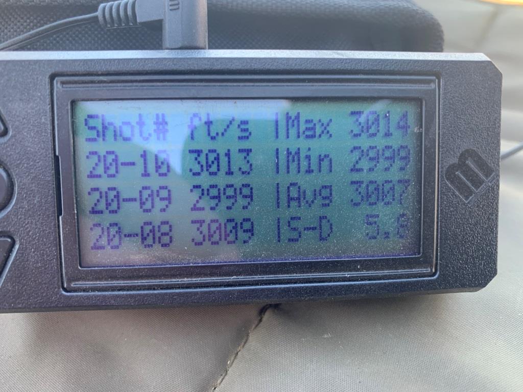

223 unturned LC brass. Top is my current 75 ELDm load, below is the 80ELDm, below that is 80AMax. Small cases are a pain. This test covered 2 powders and 3 bullets. I found 1200 of the AMax while organizing my reloading supplies, so they're going to be used. This was intended as a first test to generate data for further refining a load in QL. I'm just going to use that 80 grain AMax load as is. The point is, most of what's needed for hobby use long range loads can be done pretty simply once you have a solid brass prep routine and powders/primers matched to the application.
6XC, unturned Peterson brass, 108 ELDm seated into the neck, H4350, match primers.
300 Lapua, weight sorted Lapua brass turned for full cleanup/ID & OD/ into the shoulder, 250 ATip with the back of the bearing surface in the shoulder, Retumbo, weighed match primers.
The 223 and 6XC ammo is for shooting steel, generally inside 1000 yards. The loading process is simplified because I shoot so much of it and the error budget is completely different. The SDs on this ammo is about half what can reasonably be expected from commercial match ammo.
The 300 Lapua stats are more rigorous because there are a larger number of shots and groups and because they're shot in the wild at an actual match. The larger point is the differences are small on a chrono. I'll concede the point that I don't have the skills to find neck turning differences on target. Not conclusively and on demand anyway.

For hobby ELR work, SDs below 10 and ES's below 30 are a pretty good effort. You should be able to do that with decent brass that was weight sorted when new and then forgotten about. That's for every 10 shot string in a box of 50. It probably won't happen at internet velocities for your combo....
If you can lower the SDs into mid single digits and the ES's below 20, the BC variation becomes the prominent problem beyond a mile. That's managed by keeping the barrel fresh. How fresh depends on how much you intend to shoot past 2000 yards.

280 grain Peregrine monolithic at 2780 fps. 26" barrel. My data card shows 14fps spread over 5 shots from the load development. I've gone up to 2900 with a 300 grainer [ when the barrel was at 30 inches ] in load development without stressing the brass, this slower load shoots much better.
I really don't fuss over the numbers, I want as close as possible to a full case of powder, burn complete in the barrel, easy bolt opening and to shoot inside that one moa circle up to the range of the gun. I can see from the velocity numbers when the burn is right.
