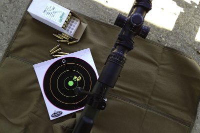

Here is an example of what I consider pretty decent shooting from both me and the rifle: 10 shots, 200 yards, prone, starting with a cold barrel. It measures .866" center-to-center. Unremarkable by many standards, but good by my own. I suspect the slight horizontal nature of the group is down to the shooter and maybe a touch of wind.

Good report. A lot of shooters shy away from some way to look at the wind. I suggest that having some sticks and surveyors' tape in front of you won't be expensive, or cause any problems, and over time, you will learn to speak their language. No serious accuracy testing can be done without them. You will be trying to fix things that probably not need fixing, that were simply caused by the wind. The good news is that you seem to be a talented shooter, that has some good equipment. Carry on.
Thank you, Boyd. I'll take the compliment but I need to find my way into competition to see if playing at the range translates into shooting good scores. I'll put together some wind flags (and I need to start keeping better notes) before my next trip out to the range.
