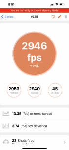

@Bob3700 I would not use the data on the shotmarker. The shotmarker was not developed for this type of data to be reliable, it is only anecdotal. Wind conditions and the stability of the backer boards can distort the numbers to a large degree. These are from the same relay, Labradar (3.74 SD) vs Shotmarker (12 SD). This is a 7mm bullet.

The SD numbers that I have stated are taken off our Shot Marker target at 600 yds. I have not taken any readings at the muzzle.

I have always been suspect of the accuracy of the chrono data from the Shot Marker. That said, the comparisons from one cartridge to another fired on the same day should at least correlate to one another.
While the unit is not calibrated , one should be able to at least compare the numbers from the BRX to the 308. At least that is my guess.

One last thought. The labradar is picking up the bullet SD at the muzzle where there are fewer variables. Once that little missile travels six foot ball fields, the variations in the bullet BC and the atmospherics will certainly play a part. I would expect the SD to be lower right off the muzzle. That is my thought anyway.

Velocities taken at the target are "referential" , at best due to all of the variables involved .The only "actual" muzzle velocities , and SD numbers that may be close to accurate are taken at the muzzle , and they are also just "close" approximations . There really aren't any "Absolutes" in this . Just the actual name; "Standard Deviation" should tell you it is a approximate measurement .
