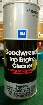

That's one big can of it that's for sure lol. At one time I tried to find it but seems hard to come by. Even tried local GM dealer. That GM stuff must be something wicked cause wipe out and sweets compared to the permatex gasket remover was not even in the same league for removing carbon on top of the piston I messed with. Just not sure I want to test it out inside my Krieger barrel yet.
An illusion. It's only a small 15oz can. That is the old TEC, great stuff. Lot of the old times will tell you that. The newer GM TEC is nowhere near as good.
I have the old TEC. and none will equal WartHog 1134, KG1 is the next best available now and i find it a distant second along with old GM TEC. If you need to soak it to get results it isn't worth talking about. jim

Nothing better than GM top engine cleaner mixed in with some Kroil.
I mix it at 25% Kroil. Some swear by 50/50, some say 1/3 Kroil. I don't know except 25% has always worked fine for me. I am hoping that the number of cans I have left outlive the rest of my days.
