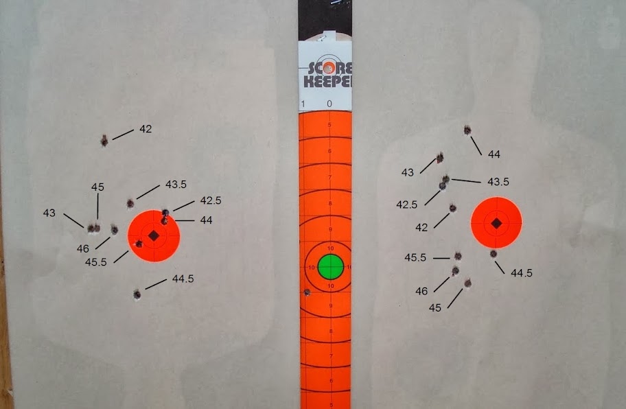

I even got into hand loading hoping that I could taylor a round to it. However, I cant even really get much data from my OCW test (100 yards) and ladder test (200 yards) because the groups were so terrible and the ladders were inconsistent between each other. I am loading SMK 168 hpbt's in fc cases, tried 42 to 46 gr varget in .5 increments, and federal 210 m match primers, 2.847 COAL (2.266 from ogive), which is about .007 from the lands.
OCW test at 100 yards. The best group was .882 inches, but that was the only group undre 1"... All of the groups averaged over 1.7".
Here is a video of my ladder tests. The video is sped up 4x. Each shot was about 1.5-3 minutes apart to make sure barrel wasnt too warm.
- [youtube]http://www.youtube.com/watch?v=l7YM5LmtP3Q[/youtube]
- Here is a still shot of the ladder test
Here is a random group shot at 200. This was a few rounds of 168 gr gold medal match I used for prefouling and dope change confirmation when I moved from 100 to 200 for my ladder tests. Its not a terrible group I suppose, but I am looking for consistent sub MOA.
Can anyone suggest a load from the tests above?
Any input is greatly appreciated.

I have the accutrigger and have it almost as light as it will go. I am thinking about a bedding job, but I still think this thing should average better than 1.7 inch groups at 100. I will try to take some macro pics of the crown tomorrow.

I was shooting from a bench with bags. The FGMM 168's were ok, but still not sub MOA at 100. You can see in the target above that I got just at an MOA at 200 when I was pre fouling for my ladder tests.

Just for kicks, I might load up about a dozen of the 42.5 and vary the OAL from .007 off the lands using three thousandths difference for each load (with three rounds at each OAL selected) and see where those print. That might at least identify the possibility of an OAL issue.
That actually sounds like a pretty good idea. I probably should have left the OAL at the standard 2.800 until I got the charge weight dialed in. I did the little trick where you dremel 4 slits in the case neck and put a bullet in the case, but leaving it long, chamber the round, then measure. I had read that its good to have it as close to the lands as possible and saw where people were having good results at .007 off the lands so I went with that. However, it might not be ideal for my rifle.
I will go load up some varying OAL's and try to test it out when I get a chance. I have to go out of town on business next week so it might be the following weekend before I can get back to the range.
