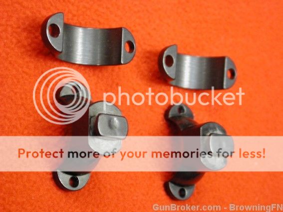

EDIT; I'm still stunned....and want to make sure we are all on the same page. This is the front and back rings I'm describing and that you are saying is "junk" ......right?
That's them... ;)
