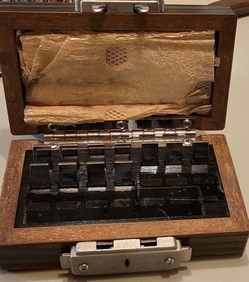

An elementary set of gauge blocks that would serve you a lifetime is a great investment to check your measuring instruments against and learn the "feel".
Some measuring tools are no good, as they will not repeat causing great difficulty. Learning the "feel" is a good thing!
