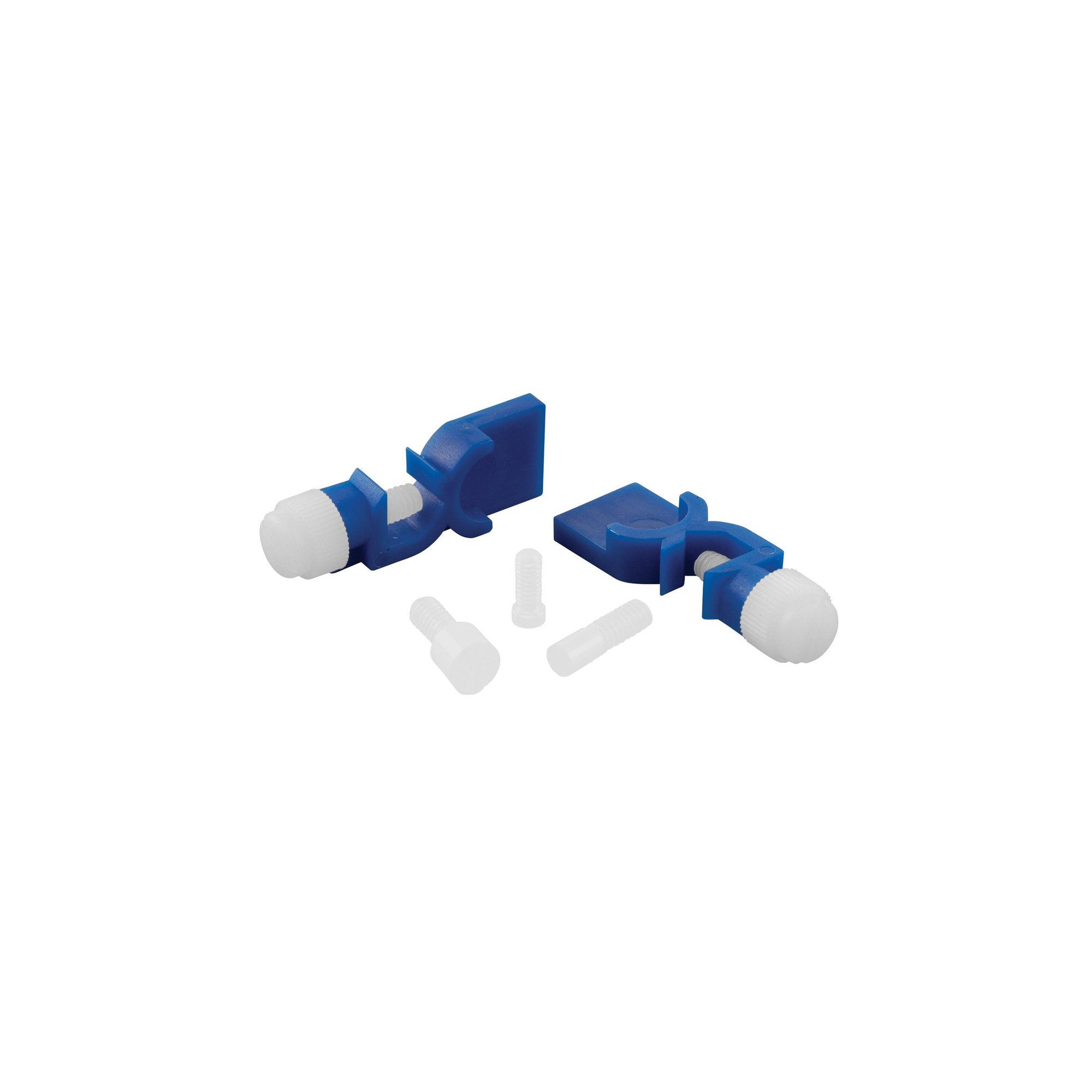

I found that the Hornady anvil base as linked to above helps with getting a consistent feel and measurement.
Yea, these can help for sure however make sure the mating surface of the anvil is mill flat.
A friend was having trouble obtaining consistent bump readings with a Hornady tool using this anvil base. We traced it to the anvil being defective, i.e., the mating surface was not flat.
